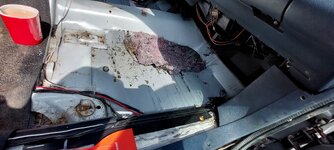

removed all the floor covering geting ready to clean paint a proteched
