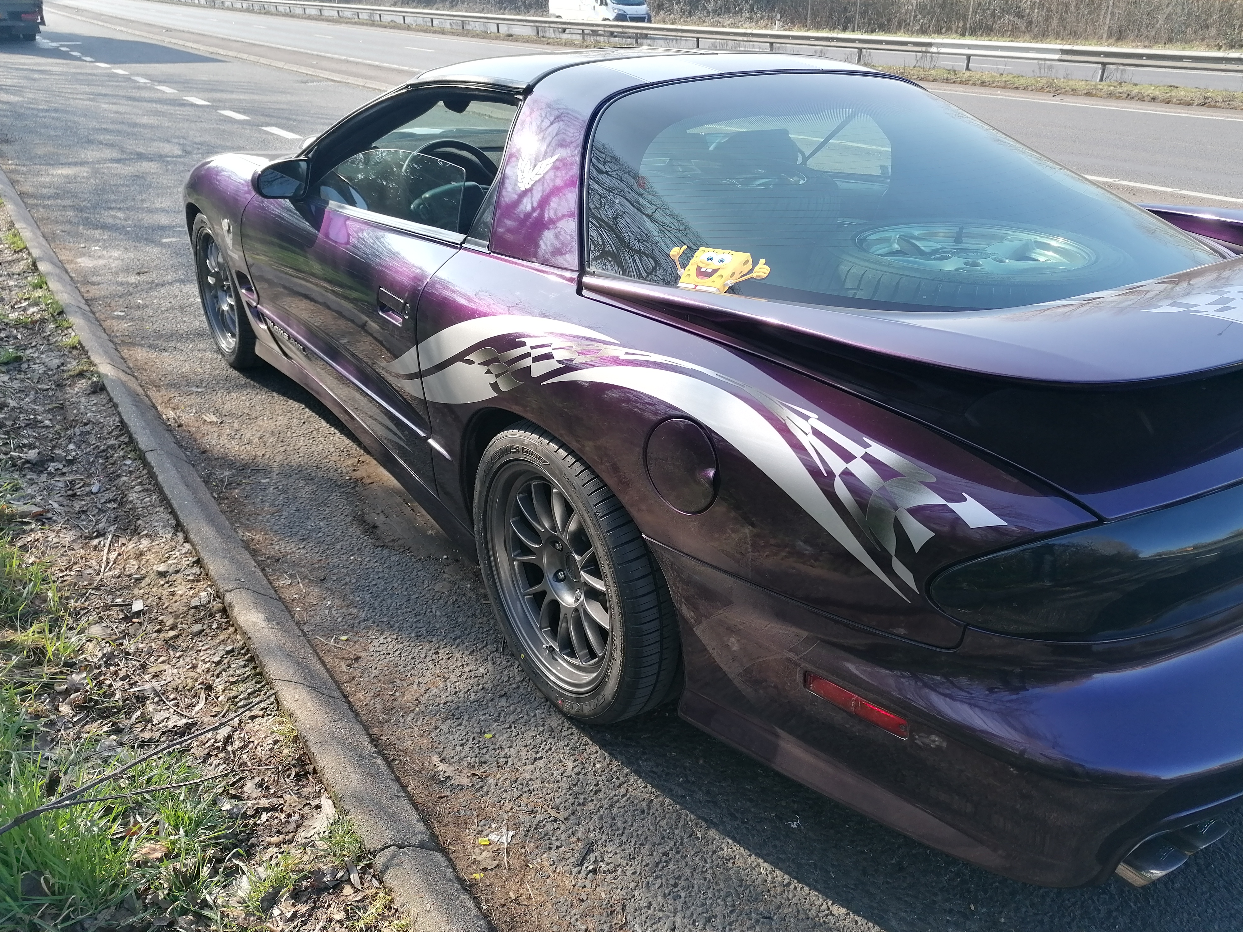

New alloys for the T/A
see sponge bob likes them as well lol,,
full
Yep sure does. Giving the double thumbs up there.
