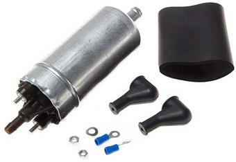

had a good look at this today, i can just feel the pump but not enough room to get a spanner in there not helped by the sealant i put over the terminals to help prevent corrosion so i bought this
then cut the wire, result i know that the pump is dead. pump feed will light up a bulb, put a battery across the pump nothing.
