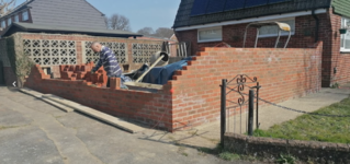

New garden wall coming along.
In that area plan to build a woodden shed, for more roof space for solar panels.

Wall is up to height along the front. Progressing well.

Wall is done. Nice big area for the new shed.
Been braking up done old concrete today where the old wall stood.
