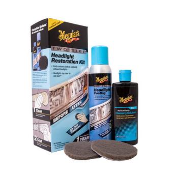

I just used this on my CRV headlights and it worked quite well. These kits were £25 online but Halfords seem to have just put the price up! It comes with a bottle of polish/cleaner, two abrasive pads and a can of the protective lacquer. Didn't take too long and has made a considerable difference. Before and after pictures below...

Wow that made a huge difference Will. thanks for the info.

Just been giving that a go. Only done one headlight as the other seemed fine. It was mainly along the top of the light so concentrated on that. I got the kit that had a sanding disk and pads that go on a drill. Started on 800 grit, then 1200 then 2000 using water too. Then polishing compound with the woolen pad on the drill. Dried off, looks very good, the bit I was focusing on looks great. However the bit that looked okay before now shows up worse than the bit I aimed for. No photos though. Applied the UV protection and wow, the whole thing looks like new. Very impressed.
